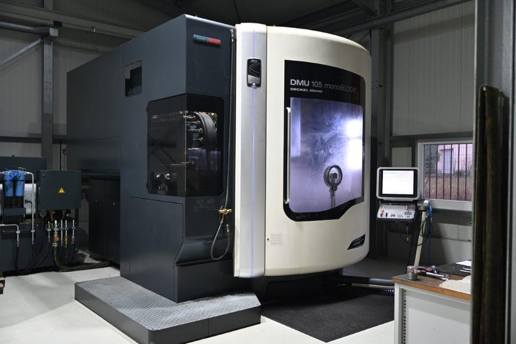

5-осевой вертикальный обрабатывающий центр DMG Mori DMU 105 monoblock
Axis 5
Tech Specs

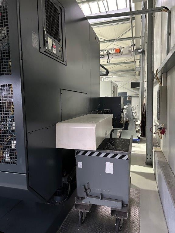

- Heidenhain iTNC 530 HSCI
- Rotation range C-axis: 360°, swivel range A-axis: +120°/-120°
- SK 40 motor spindle, spindle speed up to 18000 l/min
- Tool magazine: Vertical chain magazine basic with 60 magazine slots
- Infrared measuring probe: Heidenhain TS 649 DMG
- Tool measurement in the work area: Blum Laser
- 3D quickSET
- Scraper belt chip conveyor with 600 liter coolant system, paper belt filter, inner cooling through spindle 40 bar/23 l/min through spindle center, chip flushing in work area door
- Flushing gun, oil and emulsion mist separator, blast air through spindle center, ATC, Hand wheel iTNC530, operating mode 4
