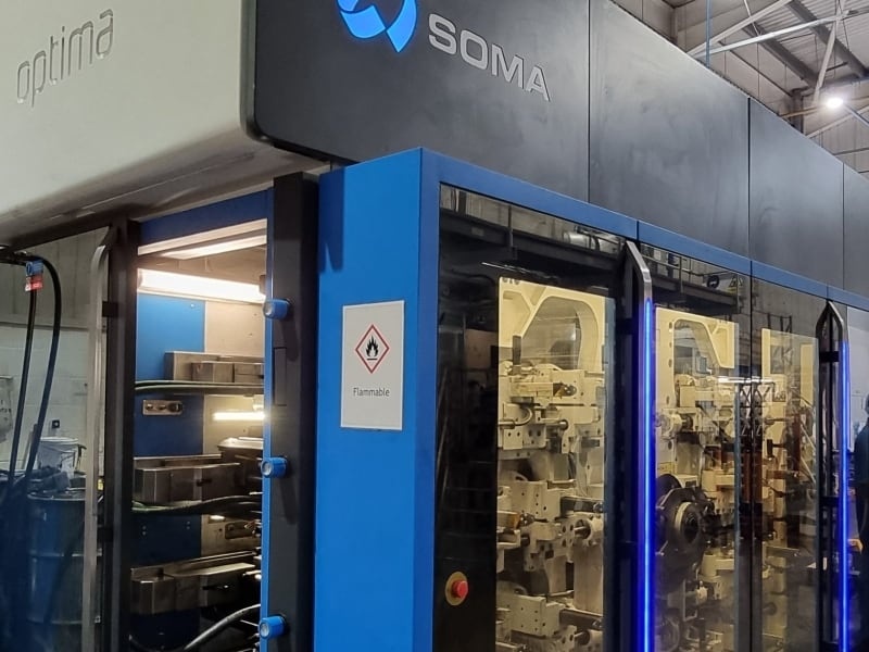

Soma Optima 2 / GEARLESS
Year 2017
Technical Specifications:
Number of Printing Units: 8
Maximum Print Width: 1270 mm
Maximum Web Width: 1320 mm
Minimum Web Width: 300–570 mm (depending on unwinding/rewinding specifications)
Minimum Repeat Length: 360 mm (ARUN system: from 380 mm)
Maximum Repeat Length: 800 mm
Repeat Length Adjustment: 0.1 mm increments; Correction ±2%
Anilox Roll Inner Diameter: 136.989 mm
Anilox Roll Circumference: 500 mm
Cord Length: 1350 mm
Maximum Mechanical Speed: 500 m/min (or 400 m/min with basic unwinding/winding)
The operating speed depends on the substrate, ink types, transfer method, plate type, image, lineature, anilox volume, etc.
Corona treatment unit (Ahlbrandt)
Gas dryer
Continuous unwinding on a roll, 1000 mm
Continuous winding on a roll, 1000 mm
Automatic viscosity control (INKSPEC)
Additional drying devices (ECLIPSE gas burners)
Web inlet/outlet extensions
Automatic core change systems
Central chiller for temperature stabilization (Hyperchill ICE039)
Kjcap Ex Ijx H Unvjbjll
Ionization system (SIMCO)
Side register control (Erhardt+Leimer)
EFFICIENCY
Maximum mechanical speed: 500 m/min
FALCON – automatic registration and print pressure adjustment
Modern print inspection system
FAST BLADE – quick doctor blade change system during operation
INKSTORM – automatic system Washers (optional)
Bosch Rexroth INDRAMAT direct drive technology
JOB MANAGEMENT – prepare future jobs from a remote PC
PRINT QUALITY
CDTS – central cylinder thermal stabilization system
PCTS – anilox and plate cylinder thermal stabilization system
PPP – plate protection
DYNAMIC IMPRESSION – electronic section pressure compensation
The machine design is specifically designed for stable printing, with composite graphite sleeves
EASE OF OPERATION
Intuitive touchscreen
Convenient web access
FASTBLADE chambered doctor blade systems with quick change
FASTADAPT – automatic chamber position adjustment
