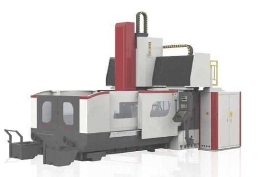

GMC1611 портальный обрабатывающий центр с ЧПУ FANUC
Обновлено 09.03.2026 486835
Specifications
Units
GMC1611
Table size
mm
1800x800
X axis travel
mm
1600
Y axis travel
mm
1100
Z axis travel
mm
600
Distance from spindle axis to column surface
mm
406.5
Distance between spindle nose and worktable surface
mm
140-740
Columns distance
mm
1100mm
Distance between table and cross beam
937
T slot(number-width-pitch)
5-18x140
Max. spindle speed
rpm
8000
Spindle taper
mm
BT40 (Optional:BT50 )
Main motor power
kw
15/18.5
Guide rail type
Linear rail
X/Y/Z rapid traverse speed
m/min
12/12/12
Max.table load
Kg
2500
Distance from table to floor
mm
Around 800
Cutting feed speed
mm/min
1-10000
Positioning accuracy
mm
±0.005/300
Repeat positioning accuracy
mm
±0.004
Tool magazine
Arm 24
Max. tool diameter
mm
φ78 (Adjacent)/ φ120(Apart)
Optional: φ112 (Adjacent)/ φ200(Apart)
Max.tool weight
kg
8 (Optional: 18)
Machine weight
kg
13000
Overall dimension
mm
4500x3000x3600
