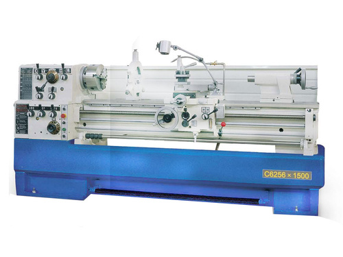

Настольно-токарный станок с низкой ценой C6251
Обновлено 09.03.2026 488248
Specification
Models
C6251×1000/1500/2000/3000
C6251V×1000/1500/2000/3000
C6256×1000/1500/2000/3000
C6256V×1000/1500/2000/3000
CAPACITY
Swing over red
510mm(20")
560mm(22")
Swing over cross slide
305mm(11-7/8")
355mm(13-3/4")
Swing in gap diameter
735mm(29")
785mm(31")
Valid length of gap
200mm(8")
Distance between centers
1000mm(40")
1500mm(60")
2000mm(80")
3000mm(120")
1000mm(40")
1500mm(60")
2000mm(80")
3000mm(120")
Center height
1135mm
1160mm
Width of bed
350mm(13-3/4")
HEADSTOCK
Spindle nose
D1-8
Spindle bore
80mm(3-1/8")
Taper of spindle bore
No.7Morse
Range of spindle speed
12changes25-1600r/min
25~1600r/min(variable)
FEEDS AND THREADS
Compound rest travel
130mm(5-1/8")
Cross slide travel
316mm(12-15/16")
Lead screw thread
6mm or 4T.P.I
Max. section of tool
25×25mm(1×1")
Longitudinal feeds range
35 kinds 0.059-1.646mm/rev (0.0022"-0.0612"/rev)
Cross feeds range
35 kinds 0.020-0.573mm/rev (0.00048"-0.01354"/rev)
Threads metric pitches
47 kinds 0.2-14mm
Threads imperial pitches
60 kinds 2-112T.P.I
Threads diametral pitches
50 kinds 4-112D.P.
Threads module pitches
39 kinds 0.1-7M.P.
TALLSTOCK
Quill diameter
75mm(3")
Quill travel
180mm(7")
Quill taper
No.5Morse
Cross adjustment
±13mm(±1/2")
MOTOR
Main motor power
7.5kW(10HP)3PH
Coolant pump power
0.1kW(1/8HP),3PH
DIMENSION AND WEIGHT
Overall dimension(L×W×H) (cm)
239×115×143
284×115×143
334×115×143
434×115×143
239×115×146
284×115×146
334×115×146
434×115×146
Packing size(L×W×H) (cm)
245×115×174
290×115×174
340×115×174
440×115×174
245×115×174
290×115×174
340×115×174
440×115×174
Net weight/Gross weight (kg)
2035/2415
2160/2550
2435/2840
2805/3270
2160/2555
2285/2690
2560/2980
2930/3410
