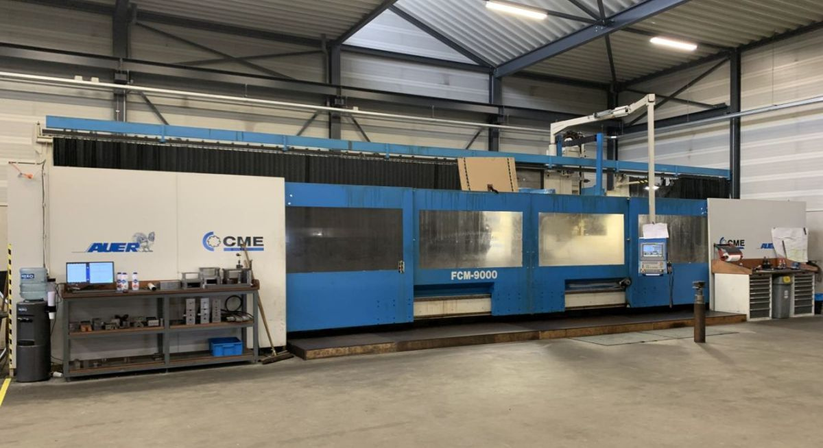

Пятиосевой продольно-фрезерный станок CME FCM 9000.
Год выпуска 2000. Выработка 13900 часов. Made in CME Machinery / Spain.

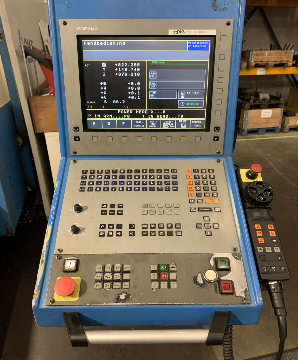

ЧПУ Heidenhain TNC 430 CB.
Стол 9500 x 1500 мм.
Макс.нагрузка на стол 5000 кг/м. общая 47500 кг.
Worktable height of floor top 850 mm
X-Axis movement 9000 mm
Y-Axis movement 1500 mm
Z-Axis movement 1500 mm
Swiveling of Vertical millinghead 1° x 1°
Min./max. distance spindle nose to table
Vertical -8 - 1492 mm
Min./max. distance spindelcentre to table surface
Horizontal 100 - 1600 mm
Horizontal 0-180° 100 - 1820 mm
Rapid traverse X-/Y- and Z-Axis 15 m/min
Diameter Ball screw X Axis 100 x 20 mm
Diameter Ball screw Y Axis 63 x 10 mm
Diameter Ball screw Z Axis 80 x 20 mm
Spindle speed
Range 1 50 - 750 Rpm
Range 2 750 - 3000 Rpm
Constant torque
Range 1 - 1100 Nm 50 - 265 Rpm
Constant power
Range 1 - 265 - 750 Rpm
Constant torque
Range 2 - 750 - 1070 Rpm
Constant power
Range 2 - 1070 - 3000 Rpm
Spindle taper DIN 69871 - SK 50
Pull stud type
Spindle drive motor 30 min/continue
380 V
Coolantpump 2,4 kW
Hydraulic pump 9 kW
Lubrication pump 1,1 kW
Maximum torque
Milling motor 1100 Nm
Dimensions 18830 / 6470 / 4025 mm . Weigth 61620 kg.

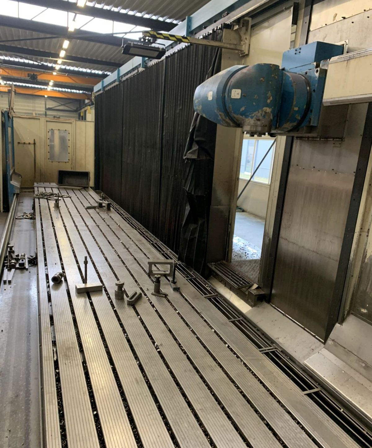

Complete with:
Ortogonal Milling head. 2 cnc controlled swivels (A & B Axis )
positioning every 1° in both bodies, and continuous
in both bodies (continuous milling)
Automatic tool charger for 60 tools
Special travel Y = 1500 mm
Automatic front doors
All round enclosure cabins
Swarf conveyors
Ram lubrication cooling system
Thru the tool cooling system
Coolant thru spindle 15 bar , 12 l/min
Coolant tank with 7 bar pump
Tool clamping Pedal
Electronic handwheel Heidenhain HR 410
Halogen lamp
Table width 1200 mm
2 steps ZF Gearbox
Grinded table surface
M03 - M05
Preparation for 4th axis
Pendelum Posibility
2 gitter stairs on both side's of the table
Gitter platform in the length on top of the chip conveyor
Paperbelt fitration with 500 Liter tank
Grinded table face
Temprerature sensor
