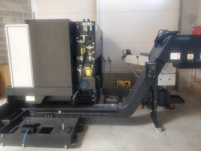

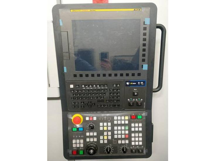

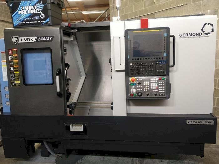

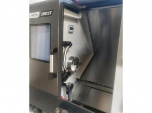

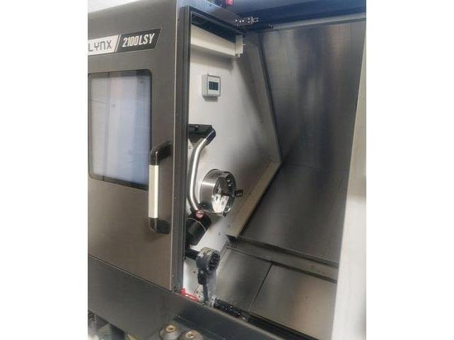

GINDUMAC GmbHTECHNICAL SPECIFICATIONS

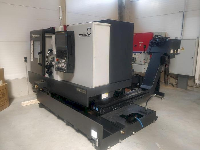

6-axis CNC lathe “DN Solutions mod. LYNX 2100LSYB” with sub-spindle ,
driven tools , and CNC DN Solutions-Fanuc i-Plus iHMI
CONTROLLER UNIT
Other CNC: Fanuc iSeries
TRAVELS
X Axis: 205 mm
Z Axis: 560 mm
Y Axis: 105 mm
CAPACITY
Max. swing diameter: 600 mm
Max. turning diameter: 300 mm
Max. turning lenght: 510 mm
Bar working diameter: 65 mm
SUBSPINDLE
Subspindle chuck diameter: 135 mm
Subspindle nose: Fl 110
Subspindle Speed: 6000 min-1
Subspindle motor power: 5,5 kW
TURRET
Stations: 16 nr
Live tools power: 3,7 kW
SPINDLE
Spindle chuck diameter: 170 mm
Spindle nose: ASA 5
Spindle speed: 6000 min-1
Spindle motor power: 15 kW
