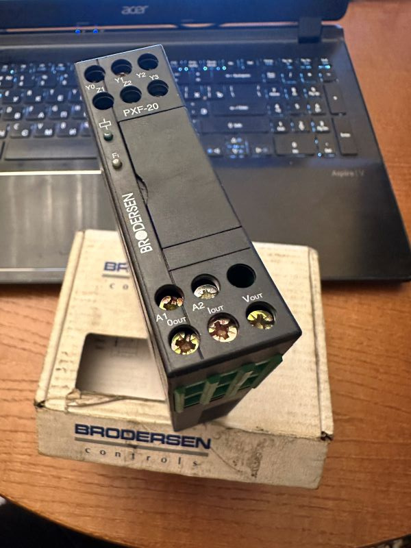

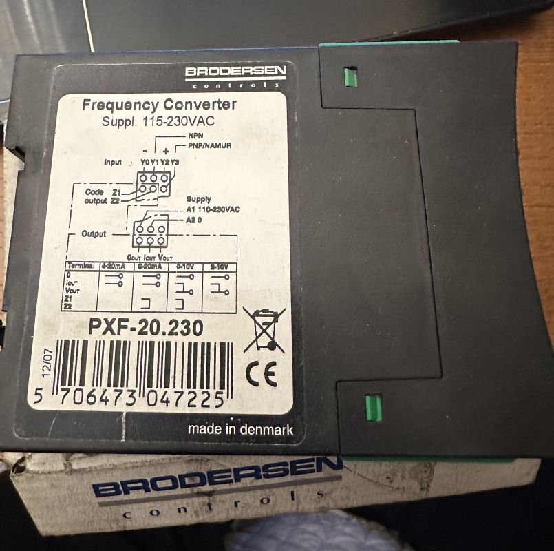

Frequency converter for converting frequency to an analogue
process signal. The frequency converter has NPN/PNP/NAMUR
input in 5 ranges from 0-5kHz.
The frequency range for input are selected by a rotary switch and
type of analogue output are selected via choice of terminal - see
connection diagram.
Features
• NPN/PNP/namur input in 5 ranges.
• Output 0-10VDC/2-10VDC/0-20/4-20mA - selected via terminals.
• Output offset and gain adjustable ±5%.
• Yellow LED indication of input less than 5%.
• Galvanically isolated supply/output.
• Internal sensor supply 12,6V to 14V @ 0-20mA.
• Operating voltage 24-48V AC/DC, 115-230V AC.
