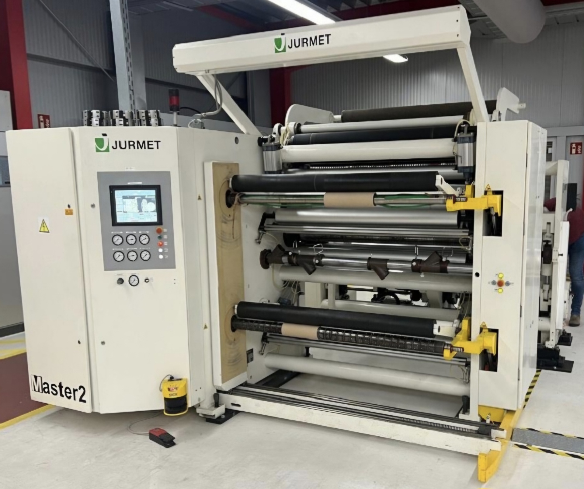

2009 г. Полиграфическое оборудование, разное
Бобинарезательная машина JURMET MASTER 2
Обновлено 28.09.2026 988061
Equipment/machine description
Process:
Slitter rewinder
Name:
JURMET MASTER 2
Producer:
Jurmet
Production year :
2009
Hours worked:
~11.000 h
Technical specification
Materials:
Films OPP, PP, PS thickness from 14 to 100 µ
PET from 20 to 200 µ
Paper from 15 to 150 g/m2
Aluminium thickness from 15 to 60 µ
Laminates:
Paper + aluminium foil + PE from 15 to 150 g/m2
Max working speed:
700 m/min
Max Material width:
1300 mm
Max Material width:
300 mm
Unwinder max roll diameter:
1300 mm
Unwinder shaft diameter:
76 mm (3") and 152 mm (6")
Unwinder max roll weight:
2400 kg
Web tension control:
YES. Pneumatical
Splice table:
Yes. With pneumatical clamps and tape dispenser.
Web Guide:
Yes. Upgraded to Laser Sensor Keyence with new control panel. Automatic
Material Path:
Top bridge
Slitting unit:
Circular blades with pneumatical bottom knife shaft. With belt
Auto knife positioning:
Yes. Pneumatical positioning arm
Razor blades:
No. Available optionally.
NIP roller in slitting unit:
YES.
Banana roller in slitting unit:
YES. Pneumatical positioning arm
Trim blower:
YES.
Rewinder Double shaft:
Rewinder friction rings shafts:
YES.
Rewinder Pressure arms:
YES. Pneumatical from top
Laser Corre positioning:
YES
Automatic rolls removing:
YES. Rolls moved on a tower
Rewinder roll max diameter:
800 mm
Rewinding min width:
50 mm
Rewinder roll max weight:
500 kg
Power Installed :
54 kW
Max power consumption:
33 kW
Dimensions (W x L x H):
3500 x 4300 x 2305 mm
Weight of unwinder
4540 kg
Weight rewind unit:
4520 kg
