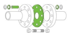

China Industrial Valve Seal Kits Manufacturer Provides Low-Emission Valves and High-Performance Packing & Sealing Materials for Demanding Applications.Flange connections are one of the most widely used methods for joining components in industrial piping systems. Commonly found in pipelines, valves, and equipment, they rely on the combined action of bolts, flanges, and gaskets to achieve a tight seal and ensure safe fluid transmission. This article explores the sealing mechanisms, influencing factors, and maintenance strategies necessary for optimizing the performance and reliability of flange connections.
Sealing Principle of Flange Connections
At the core of flange connections lies the sealing mechanism, primarily achieved through the interplay of three critical components: bolts, flanges, and gaskets. Among them, the gasket is the key sealing element. When bolts are tightened, they apply a pre-tension force that compresses the gasket between the flange faces. This pressure causes the gasket to deform and fill the micro-irregularities on the sealing surfaces, thereby creating a leak-proof seal.
For effective sealing, the gasket must endure a certain clamping force, quantified as specific pressure. During operation, internal pressure can induce axial forces that tend to separate the flanges and elongate the bolts, reducing the clamping force on the gasket. If this force drops below the effective clamping threshold, the seal may fail, leading to leakage or even gasket blowout. Thus, maintaining a clamping force greater than the pipeline's operating pressure is essential.
