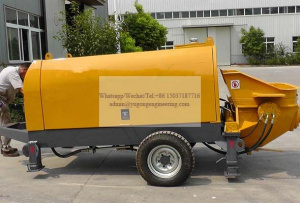

 The concrete delivery pump includes a pump body and a delivery pipe. It is a machine that uses pressure to continuously transport concrete along the pipeline. It is mainly used in house construction, bridge, and tunnel construction. With the rapid advancement of urbanization and the rapid development of urban buildings, the demand for concrete pumps is gradually increasing. YG concrete pump manufacturer offers many types of concrete pumps. We will introduce you to the machine details.
