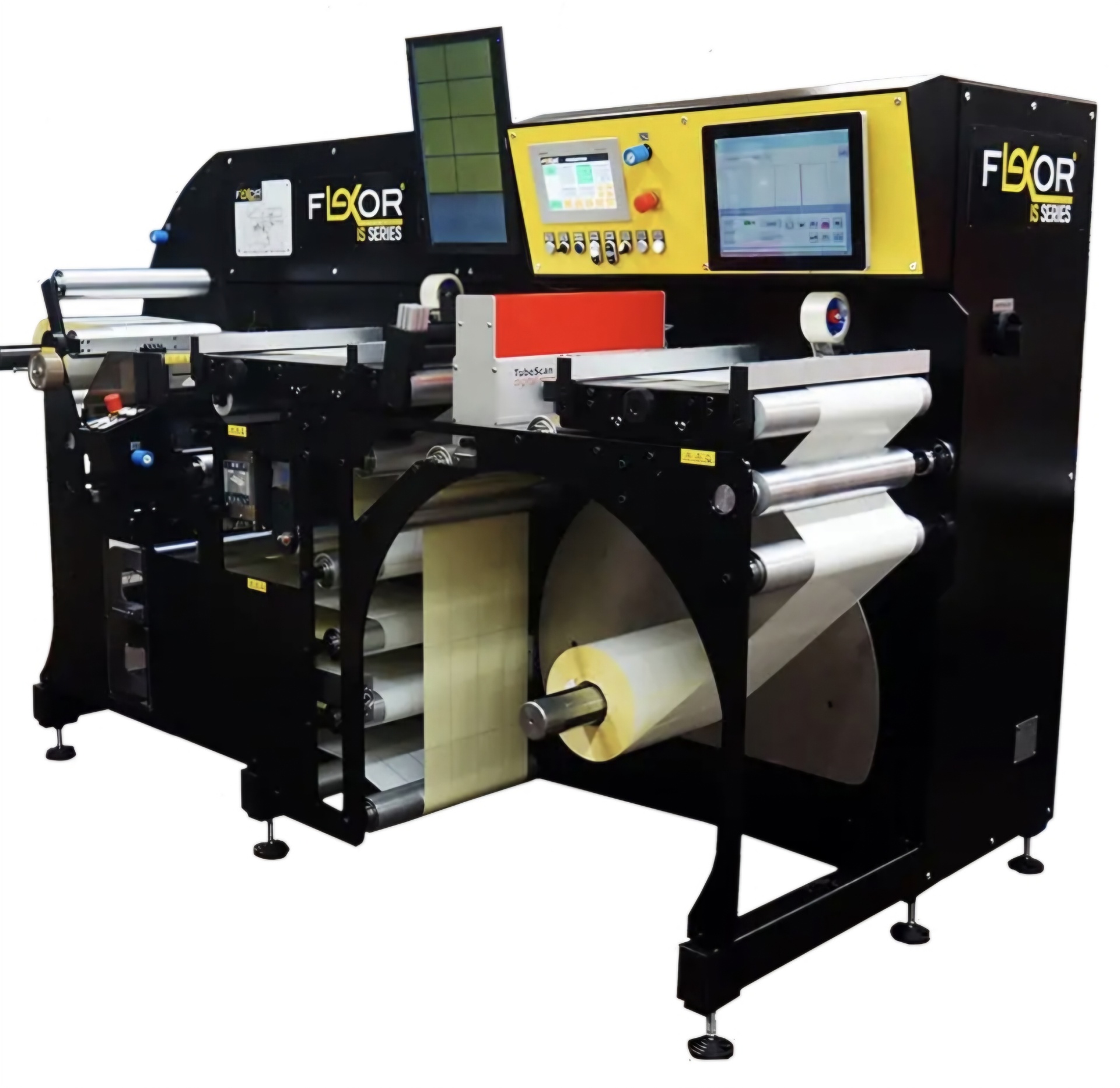

Flexor 440IS with EyeC ProofRunner Web 450 print image inspection system and REA-JET HR 4K printing system.
The Flexor 440IS is the ideal fully integrated 100% inspection solution. The 440IS machine allows the operator to inspect a web width of up to 440 mm and remove defects. The machine offers flexibility and high performance demanded by customers with the highest quality standards.
High-speed inspection, low maintenance costs, and full integration of the 100% inspection camera provide converters with a package that exceeds all expectations.
- Machines for 100% Inspecting, Slitting and Rewinding
- Perfect solution for a fast and efficient quality control finishing machine
- integrated active buffer for easy web pass
- Fully Servo Motor driven with Job Memory
Market Segments:
Pharmaceutical
Cosmetics
Food and beverage
Chemical
Label Types:
SA paper and plastic labels
PS paper and plastic labels
No label look
Thermo transfer
Peel and Read
Sandwich Label
It features an integrated vision camera system from one of our partners, two webguiding devices, a splice table, waste rewinder, shear and razor cutting system. This is a highly productive machine with speeds of up to 250m/min for efficient and effective label production where 100% inspection is required. The IS Series is mostly used in pharma and cosmetic label production.
Product features:
100% Inspection
- The IS Series can be seen as a platform on which you can install any 100% inspection camera system
- BST Tubescan, NIKKA, AVT, EYE-C what ever your need or budget we can cater
- Fully integrated, fully wired –> part of the machine
Servo Technology / S-Drive
- S-Drive machines will make your production lean, quick, reliable and ultra fast
- Accurate tenstion control settings, automatic and safe slow down and start up for any label length
- Online Diagnostics
- Unlimited Job Memory
Build in IQ
- All IS Series machines have build in counters for labels and meters/feet
- Fully integrated camera with active buffer for easy web treading
- No more setting label lengths, the machine will automatically calculate it and adjust the start up and slow down ramps
- Build waste rewinder
- Adjustable splice table clamps for almost any size label
Slitting
- Cassette type slitting makes knife changes easy and quick
- Set your knives outside the machine on a dedicated knife block which corresponds to the machine knife cassette
- Slitting between two driven NIP Rollers makes it effortless and easy to setup allowing the operator to rewind lose rolls without compromosing slitting quality
Rewinder
- The Flexor IS Series offers you a single servo driven rewinder as a standard feature, it comes with a 76mm pneumatic shaft which is within second changeable to any size from 19mm – 152mm
- Optional Double rewinder for those tough jobs which cannot be rewound using just one rewinder
- The optional Semi Turret speeds up the rewinding process significantly making the machine even more productive without investing into a full blown turret rewinder machine
