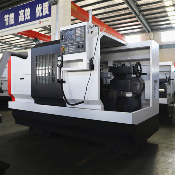

CK6150 Токарный станок с ЧПУ из Китая
Обновлено 09.03.2026 486242
SPECIFICATIONS
Units
CK6136
CK6140
CK6150
Swing over bed
mm
360
400
500
Swing over cross slide
mm
200
220
280
Distance between centers
mm
750/1000/1500/2000
750/1000/1500/2000
750/1000/1500/2000
Spindle bore
mm
52(Optional 80)
52(Optional 80)
52(Optional 80)
Spindle bore taper
MT6
MT6
MT6
Spindle nose type
C6
C6
C6
Spindle speed steps
Manual 2 steps
Manual 2 steps
Manual 2 steps
Spindle speed range
rpm
L:100-500 H:500-1800 (Optional 90-1800 stepless)
Turret/tool post
Electric 4 position
Electric 4 position
Electric 4 position
Tool size
mm
25 x 25
25 x 25
25 x 25
X axis travel
mm
200
230
280
Z axis travel
mm
750/1000/1500/2000
750/1000/1500/2000
750/1000/1500/2000
X axis rapid traverse
mm/min
6000
6000
6000
Z axis rapid traverse
mm/min
10000
10000
10000
Tailstock quill diameter
mm
75
75
75
Tailstock quill taper
MT5
MT5
MT5
Tailstock quill travel
mm
140
140
140
Main spindle motor
kw
4
5.5
5.5
Coolant pump motor
kw
0.09
0.09
0.09
Weight for 750
kg
1600
1700
1800
Weight for 1000
kg
1700
1800
1900
Weight for 1500
kg
1800
1900
2000
Weight for 2000
kg
1900
2000
2100
Dimension for 750
mm
2200x1600x1650
2200x1650x1700
2200x1700x1750
Dimension for 1000
mm
2500x1600x1650
2500x1650x1700
2500x1700x1750
Dimension for 1500
mm
3000x1600x1650
3000x1650x1700
3000x1700x1750
Dimension for 2000
mm
3500x1600x1650
3500x1650x1700
3500x1700x1750
