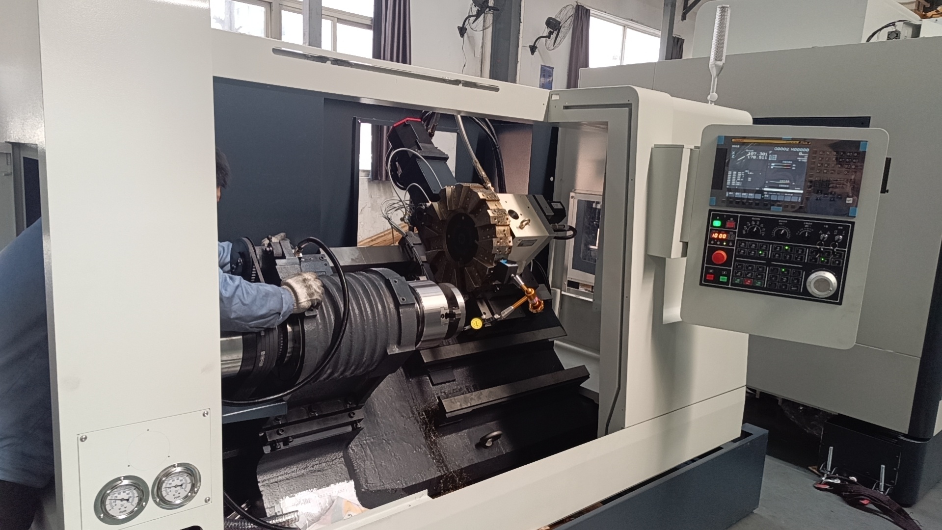

Станкофф.RUSpecification Model | S620 | |
Rotation diameter over bed | mm | Φ610 |
Rotating diameter on saddle | mm | Φ420 |
Maximum turning diameter | mm | Φ520 |
Maximum turning length | mm | 1000 |
Hydraulic chuck | Inch | 12"(optional) |
Maximum bar diameter | mm | Φ65 |
Spindle through hole diameter | mm | Φ86 |
Spindle bearing diameter | mm | Φ120 |
Spindle speed | rpm | 3200 |
Spindle nose | A2-8 | |
Spindle motor (continuous/30 minutes) | kw | 11/15 |
X-axis motor | kw | 2.5 |
Z-axis motor | kw | 2.5 |
X-axis travel | mm | 295 |
Z-axis travel | mm | 1100 |
X-axis rapid movement speed | m/min | 24 |
Z-axis rapid movement speed | m/min | 20 |
Number of tool holder stations | Pcs | 12 |
External knife specifications | mm | □25 |
Hole cutting tool specifications | mm | Φ40 |
Servo tailstock travel | mm | 900 |
Tailstock sleeve travel | mm | 100 |
Tailstock sleeve diameter | mm | 100 |
Tailstock sleeve taper hole | M.T.5 | |
Hydraulic tank capacity | L | 60 |
cutting fluid capacity | L | 350 |
Positioning accuracy (X/Z axis) | mm | 0.010/0.012(actual) |
Repeatability (X/Z axis) | mm | 0.005/0.007(actual) |
Machine size (length × width×height ) | mm | 4393*2053*2210 |
Machine net weight | kg | 8000 |
CNC system | FANUC Oi TF PLUS type 1+ Manual guide | |
