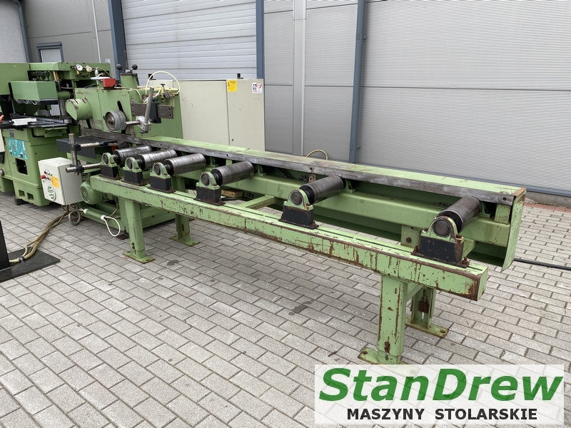

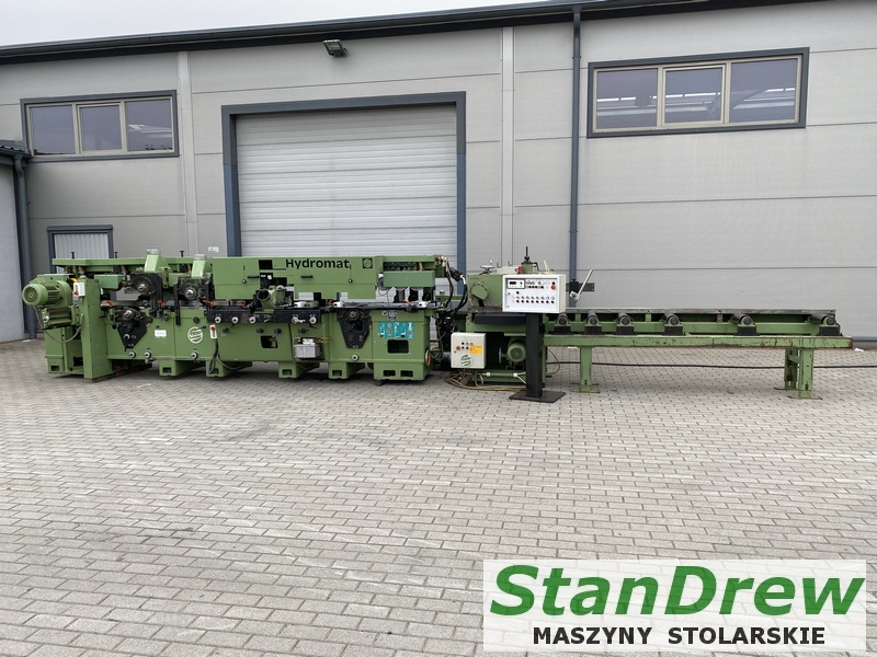

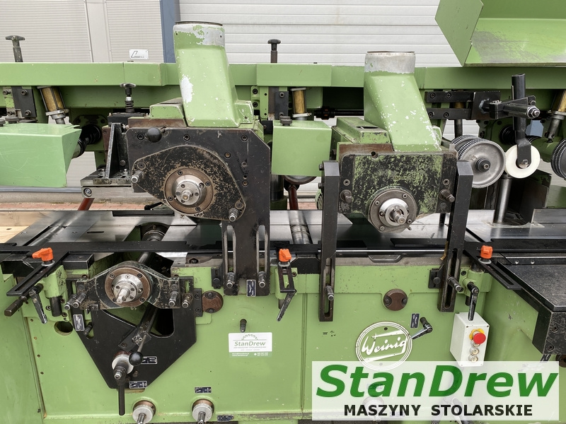

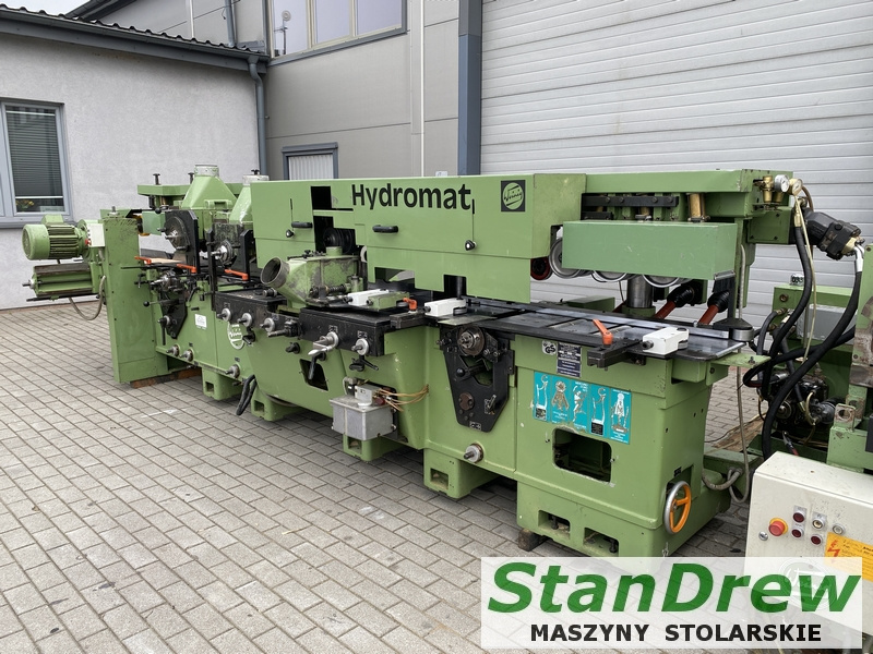

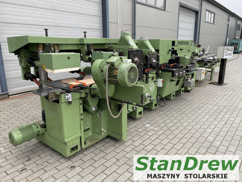

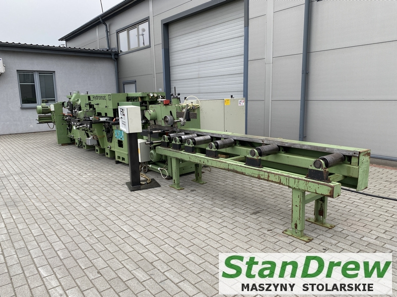

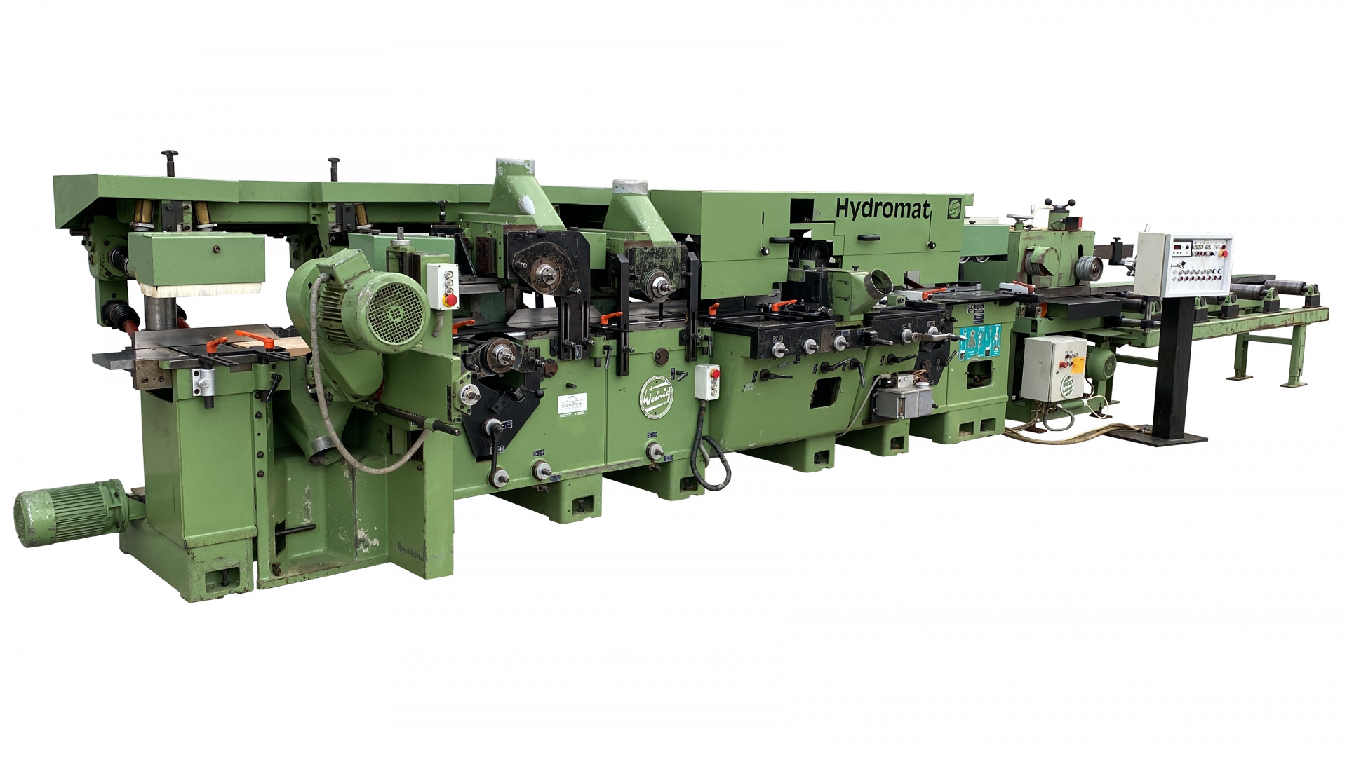

StanDrewWeinig Hydromat H25N four-sided planer with 100 m/min feeder
- German production
- hydraulic feed up to 100 m/min
- for wet wood
- feeding table

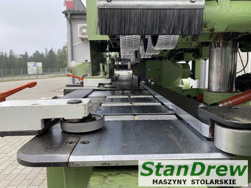

TECHNICAL PARAMETERS:
planing width 250 mm
planing height 190 mm
spindle diameter 50 mm
electric height adjustment

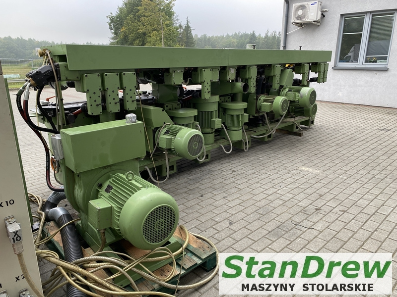

1 lower spindle 15 kW
2 right spindle 7.5 kW
3 left spindle 15 kW
4 right spindle 7.5 kW
5 upper spindle 7.5 kW
6 upper spindle 15 kW
7 lower spindle 7.5 kW
8 universal spindle 1800 7.5 kW
feed smoothly adjustable up to 100 m/min
feed pump motor power 22 kW

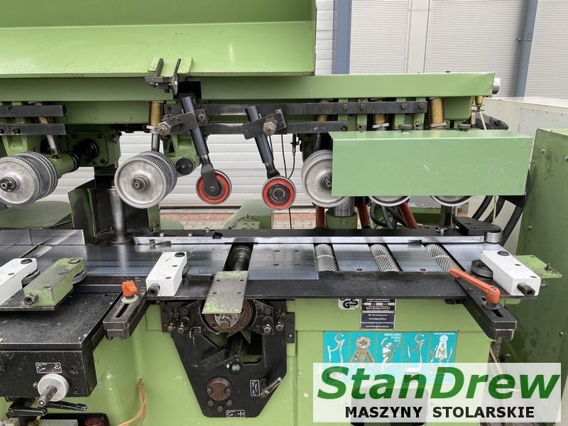

nine rollers in the table top, three of which are in front of the first head
seven upper steel pulling rollers
four upper rubber pulling rollers
pneumatic pressure
jointer on 1-6-7 spindle
automatic lubrication of the countertop
feeding table 3000 mm
speed smoothly adjustable up to 100 m/min
two upper pneumatic rollers
six lower pulling rollers
minimum material length 650 mm
Transport dimensions
11000x2400x2000 mm
weight 9 tons
